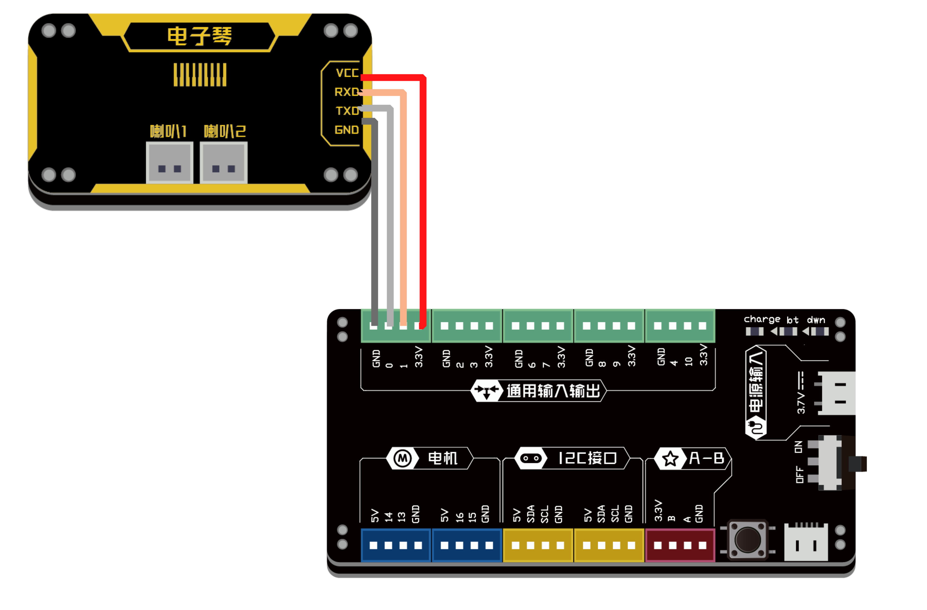

1.RXD连接至microbit串口的TX,在定义串口引脚时需要注意下!
2.串口波特率:31250bps
3.程序烧下载完成后须断电重启

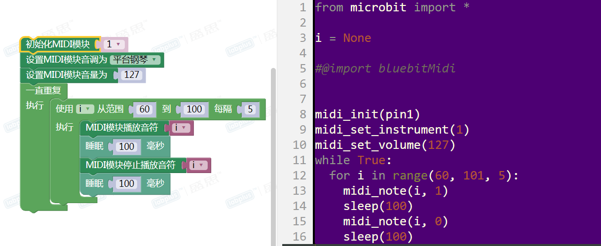

python示例
| 连接示意图
from microbit import *
def midi_init(pin):
uart.init(baudrate=31250,tx=pin)
sleep(30)
uart.write(bytearray([0xb0,0x78,0x00]))
sleep(5)
uart.write(bytearray([0xb0,0x79,0x7f]))
sleep(15)
def midi_set_volume(vol):
uart.write(bytearray([0xb0,0x07,vol]))
sleep(10)
def midi_set_instrument(ins):
uart.write(bytearray([0xc0,ins]))
sleep(10)
def midi_note(note, on_off):
if on_off == 1:
uart.write(bytearray([0x90,note,0x7f]))
elif on_off == 0:
uart.write(bytearray([0x80,note,0x00]))
sleep(5)
#test code
music=bytearray([60,62,64,60,60,62,64,60,64,65,67,64,65,67]) #两只老虎
duration=bytearray([1,1,1,1,1,1,1,1,1,1,2,1,1,2]) #节拍
music_len=len(music)
midi_init(pin1) #设置串口tx引脚
midi_set_instrument(58) #设置音色
midi_set_volume(100) #设置音量,范围 0-127
for i in range(music_len):
midi_note(music[i],1)
sleep(200*duration[i])
midi_note(music[i],0)
sleep(200)
