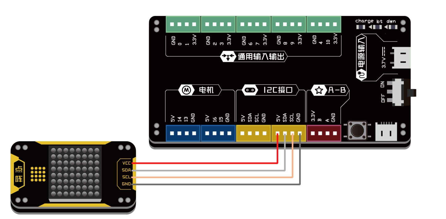

| VCC |
| SDA |
I2C数据
| SCL |
I2C时钟
| GND |

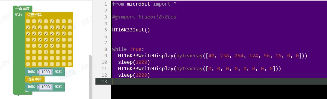

MicroPython示例
连接示意图
from microbit import *
acsii_charactor = [
[0x30,0x48,0x48,0x48,0x48,0x48,0x30,0x00], # 0
[0x20,0x60,0x20,0x20,0x20,0x20,0x70,0x00], # 1
[0x30,0x48,0x08,0x10,0x20,0x40,0x78,0x00], # 2
[0x30,0x48,0x08,0x30,0x08,0x48,0x30,0x00], # 3
[0x10,0x30,0x30,0x50,0x50,0x78,0x10,0x00], # 4
[0x78,0x40,0x40,0x70,0x08,0x08,0x70,0x00], # 5
[0x30,0x48,0x40,0x70,0x48,0x48,0x30,0x00], # 6
[0x78,0x48,0x08,0x10,0x20,0x20,0x20,0x00], # 7
[0x30,0x48,0x48,0x30,0x48,0x48,0x30,0x00], # 8
[0x30,0x48,0x48,0x38,0x08,0x48,0x30,0x00], # 9
[0x30,0x48,0x48,0x48,0x78,0x48,0x48,0x00], # A
[0x70,0x48,0x48,0x70,0x48,0x48,0x70,0x00], # B
[0x30,0x48,0x40,0x40,0x40,0x48,0x30,0x00], # C
[0x70,0x48,0x48,0x48,0x48,0x48,0x70,0x00], # D
[0x78,0x40,0x40,0x70,0x40,0x40,0x78,0x00], # E
[0x78,0x40,0x40,0x70,0x40,0x40,0x40,0x00], # F
[0x30,0x48,0x40,0x58,0x48,0x48,0x30,0x00], # G
[0x48,0x48,0x48,0x78,0x48,0x48,0x48,0x00], # H
[0x70,0x20,0x20,0x20,0x20,0x20,0x70,0x00], # I
[0x08,0x08,0x08,0x08,0x48,0x48,0x30,0x00], # J
[0x48,0x48,0x50,0x60,0x50,0x48,0x48,0x00], # K
[0x40,0x40,0x40,0x40,0x40,0x40,0x78,0x00], # L
[0x48,0x78,0x78,0x48,0x48,0x48,0x48,0x00], # M
[0x48,0x68,0x68,0x58,0x58,0x48,0x48,0x00], # N
[0x78,0x48,0x48,0x48,0x48,0x48,0x78,0x00], # O
[0x70,0x48,0x48,0x70,0x40,0x40,0x40,0x00], # P
[0x30,0x48,0x48,0x48,0x68,0x58,0x38,0x00], # Q
[0x70,0x48,0x48,0x70,0x60,0x50,0x48,0x00], # R
[0x30,0x48,0x40,0x30,0x08,0x48,0x30,0x00], # S
[0x78,0x20,0x20,0x20,0x20,0x20,0x20,0x00], # T
[0x48,0x48,0x48,0x48,0x48,0x48,0x30,0x00], # U
[0x48,0x48,0x48,0x48,0x30,0x30,0x30,0x00], # V
[0x48,0x48,0x48,0x48,0x78,0x78,0x48,0x00], # W
[0x48,0x48,0x30,0x30,0x30,0x48,0x48,0x00], # X
[0x88,0x88,0x50,0x20,0x20,0x20,0x20,0x00], # Y
[0x78,0x08,0x10,0x30,0x20,0x40,0x78,0x00], # Z
[0x00,0x66,0x99,0x81,0x81,0x42,0x24,0x18], # 显示桃心
HT16K33_ADDR = 0x70
HT16K33_BLINK_CMD = 0x80
HT16K33_BLINK_DISPLAYON = 0x01
HT16K33_BLINK_OFF = 0
HT16K33_BLINK_2HZ = 1
HT16K33_BLINK_1HZ = 2
HT16K33_BLINK_HALFHZ = 3
HT16K33_CMD_BRIGHTNESS = 0xE0
TM1650_CDigits = [0x00]
def HT16K33SetBrightness(brightness):
b = brightness
if b > 15:
b = 15
var = HT16K33_CMD_BRIGHTNESS | b
i2c.write(HT16K33_ADDR, bytearray([var]))
def HT16K33BlinkRate(rate):
r = rate
if r > 3:
r = 0
r <<= 1
var = HT16K33_BLINK_CMD | HT16K33_BLINK_DISPLAYON | r
def HT16K33Init():
i2c.write(HT16K33_ADDR, bytearray([0x21]))
HT16K33BlinkRate(HT16K33_BLINK_OFF)
HT16K33SetBrightness(15)
def HT16K33WriteDisplay(x): #
var = bytearray([0x00,
x[0],0x00,
x[1],0x00,
x[2],0x00,
x[3],0x00,
x[4],0x00,
x[5],0x00,
x[6],0x00,
x[7],0x00])
i2c.write(HT16K33_ADDR, var)
# text code
HT16K33Init()
fill_bitmap = bytearray([0x30,0x48,0x48,0x48,0x78,0x48,0x48,0x00]) #display "A"
HT16K33WriteDisplay(fill_bitmap)
| 程序功能:点阵显示特定的图形
