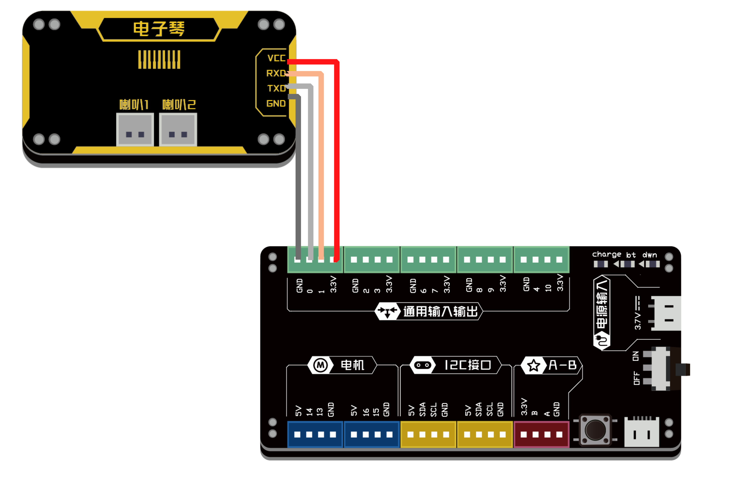

  • 通讯方式:UART
  • 集成功放、双声道喇叭
RXD 串口接收
TXD 串口发送
1.RXD连接至microbit串口的TX,在定义串口引脚时需要注意下!
2.串口波特率:31250bps

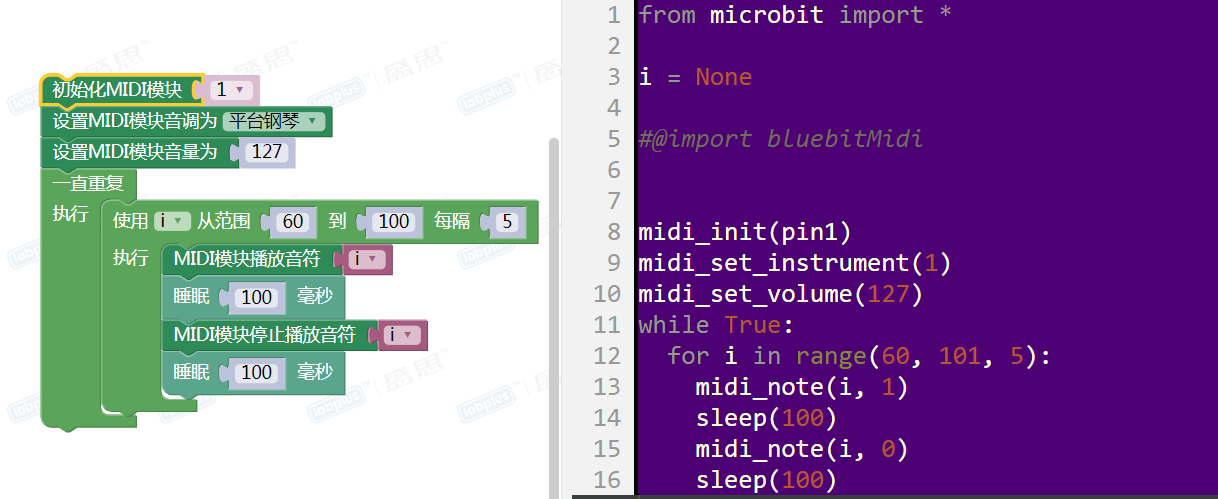

python示例
连接示意图
from microbit import *
def midi_init(pin):
    uart.init(baudrate=31250,tx=pin)
    sleep(30)
    uart.write(bytearray([0xb0,0x78,0x00]))
    sleep(5)
    uart.write(bytearray([0xb0,0x79,0x7f]))
    sleep(15)
def midi_set_volume(vol):
    uart.write(bytearray([0xb0,0x07,vol]))
    sleep(10)
def midi_set_instrument(ins):
    uart.write(bytearray([0xc0,ins]))
    sleep(10)
def midi_note(note, on_off):
    if on_off == 1:
        uart.write(bytearray([0x90,note,0x7f]))
    elif on_off == 0:
        uart.write(bytearray([0x80,note,0x00]))
    sleep(5)
#test code
music=bytearray([60,62,64,60,60,62,64,60,64,65,67,64,65,67])     #两只老虎
duration=bytearray([1,1,1,1,1,1,1,1,1,1,2,1,1,2])                #节拍
music_len=len(music)
midi_init(pin1)                             #设置串口tx引脚
midi_set_instrument(58)                     #设置音色
midi_set_volume(100)                        #设置音量,范围 0-127
    for i in range(music_len):
        midi_note(music[i],1)
        sleep(200*duration[i])
        midi_note(music[i],0)
        sleep(200)
