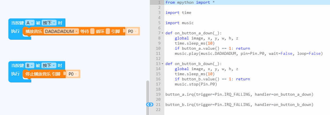

MicroPython示例
  • 以下是microbit内置的音乐旋律,import music,后可使用music.play播放
music.DADADADUM music.ENTERTAINER music.PRELUDE music.ODE music.NYAN music.RINGTONE music.FUNK music.BLUES music.BIRTHDAY music.WEDDING music.FUNERAL music.PUNCHLINE music.PYTHON music.BADDY music.CHASE music.BA_DING music.WAWAWAWAA music.JUMP_UP music.JUMP_DOWN music.POWER_UP music.POWER_DOWN
from microbit import *
import music
i = None
  if button_a.is_pressed():
    music.play(music.NYAN, pin0, wait=True, loop=False)
  if button_b.is_pressed():
    music.stop(pin0)
想了解有关BBC micro:bit for music module更详细使用,可到BBC micro:bit MicroPython

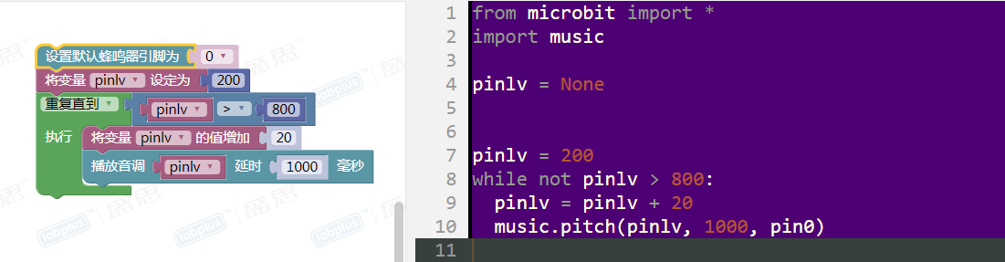

程序功能:蜂鸣器播放音高逐渐升高的声音
