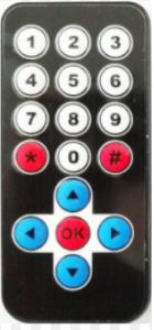

下表为附件遥控器的按键对应值表
遥控器.png 遥控按键 HEX(16进制) DEC(10进制)
"1" 0x00 00
"2" 0x80 128
"3" 0x40 64
"4" 0x20 32
"5" 0xA0 160
"6" 0x60 96
"7" 0x10 16
"8" 0x90 144
"9" 0x50 80
"0" 0xB0 176
"*" 0x30 48
"#" 0x70 112
"↑" 0x88 136
"↓" 0x98 152
"←" 0x28 40
"→" 0x68 104
"Ok" 0xA8 168

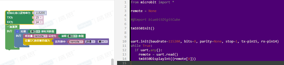

Python示例

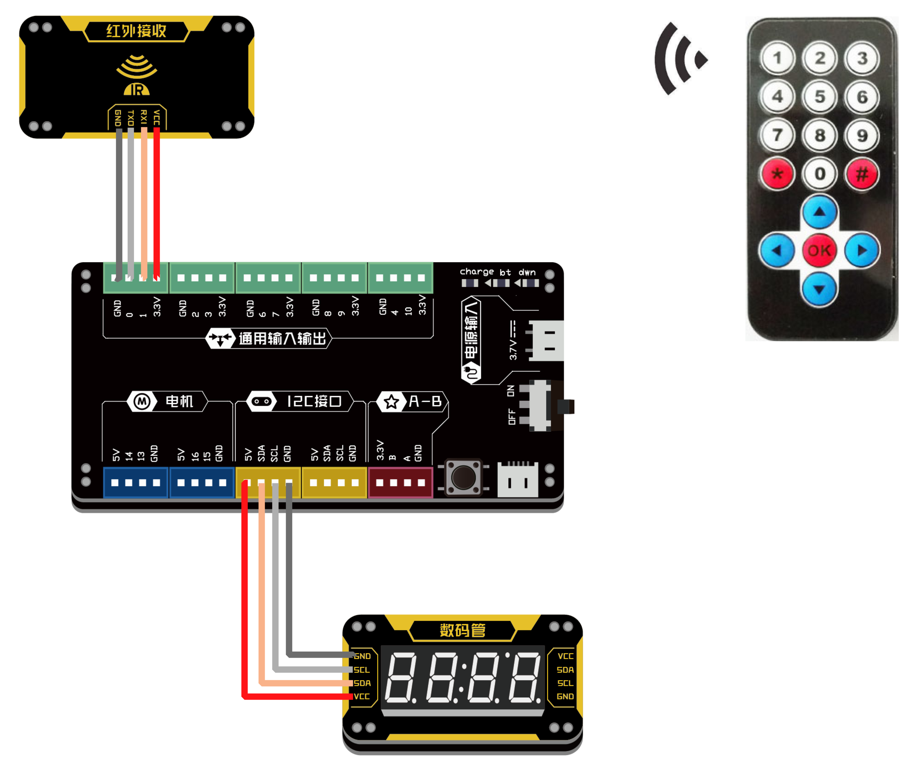

红外接收模块接收,数码管模块显示数据
from microbit import *
_TubeTab = [
    0x3F, 0x06, 0x5B, 0x4F, 0x66, 0x6D, 0x7D, 0x07, 0x7F,
    0x6F, 0x77, 0x7C, 0x39, 0x5E, 0x79, 0x71, 0x00, 0x40]
def tm1650Init():
  i2c.write(0x24, bytearray([0x01]))
def tm1650DisplayUint(x):
  charTemp = [0, 0, 0, 0]
  x = (x if x < 10000 else 9999)
  charTemp[3] = x%10
  charTemp[2] = (x//10)%10
  charTemp[1] = (x//100)%10
  charTemp[0] = (x//1000)%10
  if x < 1000:
    charTemp[0] = 0x10
    if x < 100:
      charTemp[1] = 0x10
      if x < 10:
        charTemp[2] = 0x10
  for i in range(0, 4):
    i2c.write(0x34+i, bytearray([_TubeTab[charTemp[i]]]))
def tm1650DisplayInt(x):
  x = round(x)
  if x >= 0:
  else:
    temp = (x if x > -999 else -999)
    temp = abs(temp)
    tm1650DisplayUint(temp)
    if temp < 10:
      i2c.write(0x36, bytearray([_TubeTab[0x11]]))
    elif temp < 100:
      i2c.write(0x35, bytearray([_TubeTab[0x11]]))
    elif temp < 1000:
      i2c.write(0x34, bytearray([_TubeTab[0x11]]))
display.off()
tm1650Init()
uart.init(baudrate=115200, bits=8, parity=None, stop=1, tx=pin1, rx=pin0)
    if uart.any():
        _word=uart.read()
        tm1650DisplayInt(_word[0])
连接图同上
