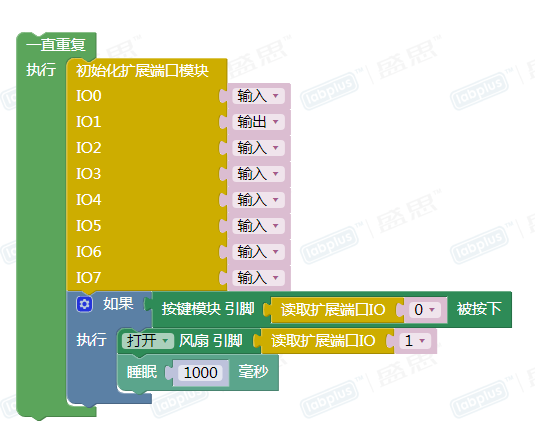

#include <Wire.h>
	Wire.begin();
	extIOInit(0, 0);    //设置IO0为输出模式
	extIOInit(1, 1);      //设置IO1为输入模式
// Add the main program code into the continuous loop() function
	if (readExtendedIO(1) == 0)
		writeExtendedIO(0, 1);
	else
