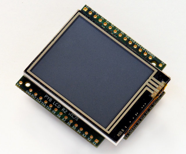

Construct an LCD160CR object. The parameters are:
connect is a string specifying the physical connection of the LCD display to the board; valid values are "X", "Y", "XY", "YX". Use "X" when the display is connected to a pyboard in the X-skin position, and "Y" when connected in the Y-skin position. "XY" and "YX" are used when the display is connected to the right or left side of the pyboard, respectively.
pwr is a Pin object connected to the LCD's power/enabled pin.
i2c is an I2C object connected to the LCD's I2C interface.
spi is an SPI object connected to the LCD's SPI interface.
i2c_addr is the I2C address of the display.
One must specify either a valid connect or all of pwr, i2c and spi. If a valid connect is given then any of pwr, i2c or spi which are not passed as parameters (i.e. they are
None) will be created based on the value of connect. This allows to override the default interface to the display if needed.The default values are:
"X" is for the X-skin and uses:
pwr=Pin("X4"),i2c=I2C("X"),spi=SPI("X")"Y" is for the Y-skin and uses:
pwr=Pin("Y4"),i2c=I2C("Y"),spi=SPI("Y")"XY" is for the right-side and uses:
pwr=Pin("X4"),i2c=I2C("Y"),spi=SPI("X")"YX" is for the left-side and uses:
pwr=Pin("Y4"),i2c=I2C("X"),spi=SPI("Y")
See this image for how the display can be connected to the pyboard.
